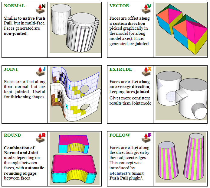

JointPushPull is a suite of extrusion tools operating on faces.
The common characteristics of JointPushPull Interactive Edition are:
- Support Pre-selection mode, with launch from toolbar, main menu, and contextual menu
- Interactive selection mode, where Faces can be selected across the boundaries of components and groups. Faces can then be visually dragged to desired offset
- Thickening and classic push-pull (i.e. original face erased)
- Options for border faces: (Contour, grid, none)
- Full support of Undo, via Ctrl-Z
- Random offset for some tools and Tapering for Normal and Extrude push-pull

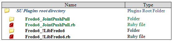

Installation of JointPushPull
IMPORTANT: Make sure that you have first installed LibFredo6
JointPushPull is released as a regular RBZ extension file on the Sketchucation Site.
- Click the red Download button if your are already logged in
- Click the red Log in to get it! button in order to log in or to register to Sketchucation as a new user (this is FREE). Then you will be able to download the RBZ file.
If you are not familiar with the installation of Sketchup extensions and Sketchucation, it is advised to watch the video LibFredo6 installation
IMPORTANT: Whatever way you choose, you MUST quit and restart Sketchup to get JointPushPull (and LibFredo6) properly loaded.
- Sketchup versions: SU2017 and above
- Language: Icon toolbar
- Menus: by default, it is installed in Tools > Fredo6 Collection > JointPushPull...
- Icon toolbar: JointPushPull

Overview of Tools
The video below gives short presentation of the 6 tools available in JointPushPull.
