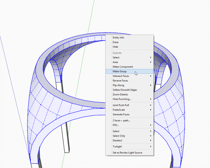

Let's make a group of what we have so far (just to keep things separately and nice and clean).

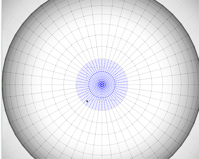

To provide even more light, the whole process above is repeated in a smaller scale on top of the raised dome. Now go to Parallel projection again and Top view. Open the upper dome group and with a right to left selection box, select the two, inner rings of facets. Delete them.

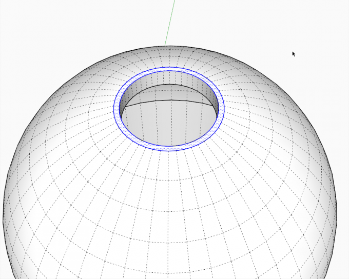

In a similar way as we created the hole in the middle in these stapes, make a smaller hole again. Redraw an edge, PushPull to exact height...
Redraw an edge, delete the inner face...
After softening, we get something like the so called "oculus" (eye) of the Ancient, Roman Pantheon. Again, copy then "Paste in place" the top ring,

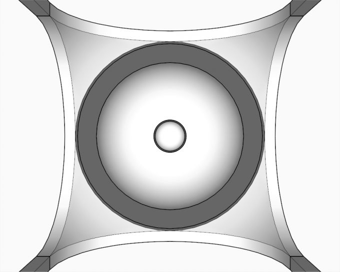

From inside, we can recognize the St Peter Basilica in Rome or the St Paul Cathedral in London - not to speak of the Capitol in Washington DC.
