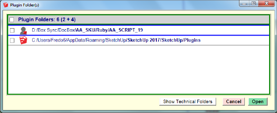

List of Plugins folders, with a direct way to open folders (useful particularly on Mac)

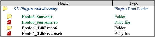

Souvenir is released as a regular RBZ extension file on the Sketchucation Site.
IMPORTANT: Whatever way you choose, you MUST quit and restart Sketchup to get Souvenir (and LibFredo6) properly loaded.

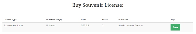

Just go to the Souvenir Purchase Page on Sketchucation.

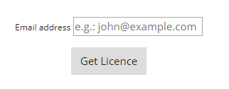

Click on the Free button, and simply enter your email address.
Then click on the button Get License . You should receive an email from Sketchucation with the Purchased License File attached, as well as some instructions to enable the license on your computer(s). Save the Purchased License File in a safe place. This is your proof of purchase.

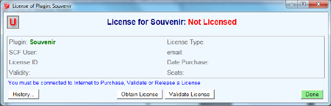

When Souvenir is NOT licensed, a button License… is displayed in the Task List and History dialog box.
Clicking on the License... Button will display the License dialog box. You can also access this dialog box from the submenu License… of the Souvenir plugin (in menu Fredo6 Collection > Souvenir). The License Dialog box gives the status of the license for the device. When Souvenir is not licensed, it is indeed empty.

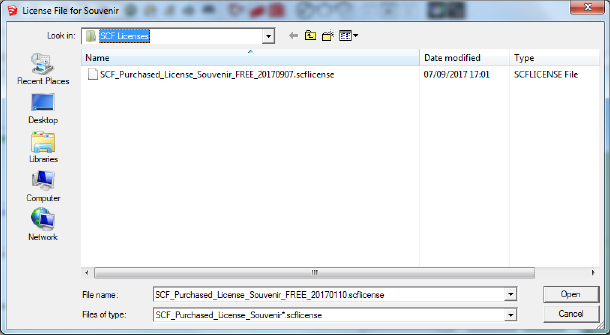

Click on the Validate License button and retrieve the Purchased License File (i.e. the file which was sent by email). You need to have an Internet connection for the Validation.

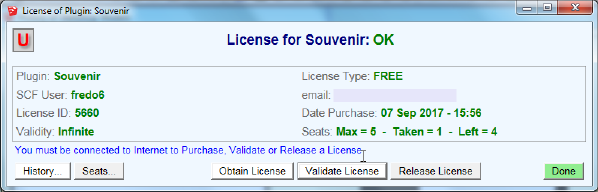

After opening the Purchased License file, the License dialog box should now show that Souvenir is licensed.
In the example above:
- The license has an Infinite validity and is of type FREE
- Souvenir Licenses are allowed for installation on 5 devices. The current installation has taken one device (e.g. one ‘seat’). You can use the same Purchased License File on 4 other devices.
YOU ARE DONE – All licensed features of Souvenir are now enabled. And if you install Souvenir on another version of Sketchup (including the next ones to come) on the same computer, Souvenir will be automatically licensed. No need to revalidate the license when you install a new release of Souvenir or Sketchup. You validate the license ONLY ONCE.

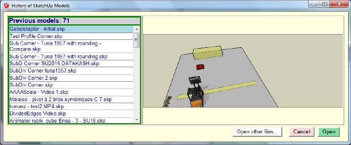

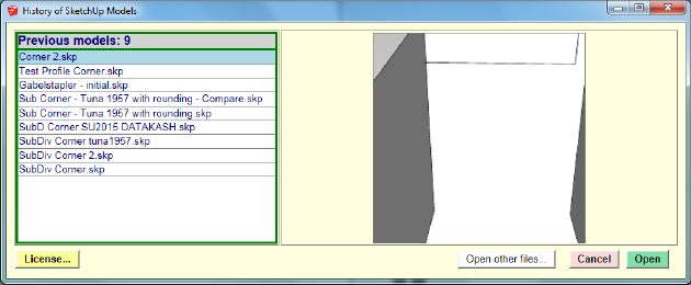

Souvenir keeps track of all models opened in Sketchup and provides the list of these models with a preview for retrieval, sorted by latest date of opening. Just click on the icon or use the menu Fredo6 Collection > Souvenir > History of Sketchup models.
Just double click on a model name in the list to open it.
If you hover over a model name, the full path of the skp file is displayed as a tooltip
The button Open other files… just call the standard Open File dialog box of Sketchup for selecting any skp file. |

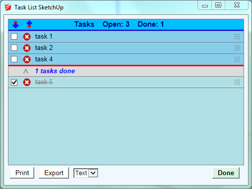

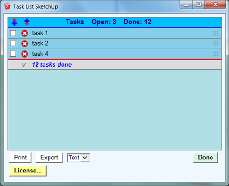

The user interface for each kind of task list is the same, and in the spirit of Google Keep
| To Create a New task | Click to the end of a task and type Enter. This will open a new task right after. If you type Shift-Enter, the new task will be created right before.
Type text for the task. Copy / Paste by dragging is supported. |
These two icons at the top of the list allow to create a new task at the very top or at the very bottom of the list. |
| Text on multiple lines | If you need the text of a task to be on several lines, type Ctrl-Enter (Windows) or Alt-Enter (Mac) to open a new line. |
| Task Done / Open | Click on the checkbox to declare the task done, or on the contrary to re-open it.
Click on the small arrow to shrink or expand the ‘Done tasks’ section |
Delete a Task![]() |
Click on Red delete button to delete the task. The icon becomes green and the text is in strike-through red. The deletion will only be effective when you save the task list, so you can change your mind by clicking on the green Undelete button. |
Re-order tasks![]() |
You can re-order a task by clicking down the icon on the right side and dragging the task around at the desired position. This also works to make a task ‘done’, by dragging it at the bottom of the list in the ‘Done’ section. |
| Print and Export | You can Print the whole task list and Export the task list as Text, or as a CSV file for Excel. |
Whenever you modify a task (text, status, delete), a button Save Changes appears. Do not forget to save your task list regularly.

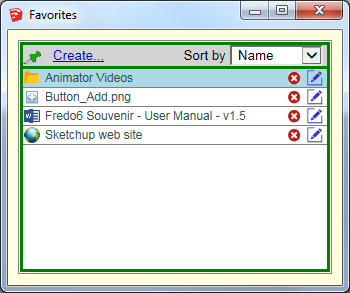

Favorites
- File
- Folder
- URL
| Open or Launch a Favorite | Double-click on the favorite name or Select the favorite with arrows or mouse click and press Enter.
Favorites are stored at Sketchup level or at Model level (displayed in blue). So you can have favorites which are specific to a model (and to all models saved-as from this model thereafter). |

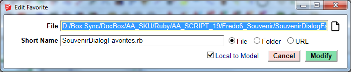

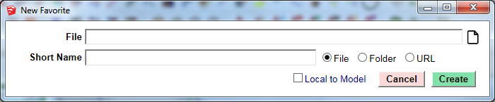

| Create a Favorite | Click on the Create... link to enter the Edition dialog for the favorite |

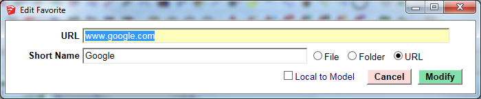

Edit a Favorite![]() |
Click on the Edit icon to enter the Edition dialog for the favorite |
When you Create or Edit a Favorite, The Edition dialog box will adapt to the specifying the type, name and link of the favorite, as shown below:
Creation
