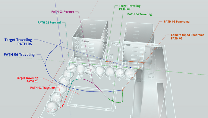

The plugin considers each point of the curve as being a key frame of the video trajectory. There are 3 remarkable points of the curve for the plugin: its starting point, the middle point (in number of keyframes), the point of arrival.
The plugin is divided into 4 steps: Step 1: You draw a curve. With the tool of your choice (welded edges, arc, circle, polyline, Bézier curve) You place 0 to 3 target components with the place target toolbar button. You assign the Start, Middle or Finish position attribute
Step 2: Converting a selected curve, or a curve and 1-3 target components, into a video path group. After having filled in the parameters, at each point of the curve, a camera component is placed and oriented according to the parameterized trajectory mode. A scene with a style is created. The video paths layer is activated on this scene only. The new scene is not added to the animation. If the "create scenes" option is activated, clicking on a camera with the interact dynamic components tool will activate the scene (Only the view of the scene, bug of the dynamic components function.)
Step 3: Possible edition of the direction of the curve to reverse the starting point of the trajectory. In the case of a closed curve, possibility of shifting the starting point. Modification of the parameters of the trajectory. Removed trajectory and related scenes. Added new targets (Enter the group) Editing parameters for targets (Enter the group, select the target and click the edit target button)
Step 4: Creating an XML file combining one or more video path groups. You select them and then order them via a dialog box). You can enter a different file name each time or overwrite an existing XML file.
