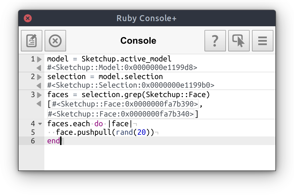

The console is a command line interface to try out codes and inspect return values. With the Enter ↵ key, code will be evaluated (use ⇧ Shift+Enter ↵ for line breaks).

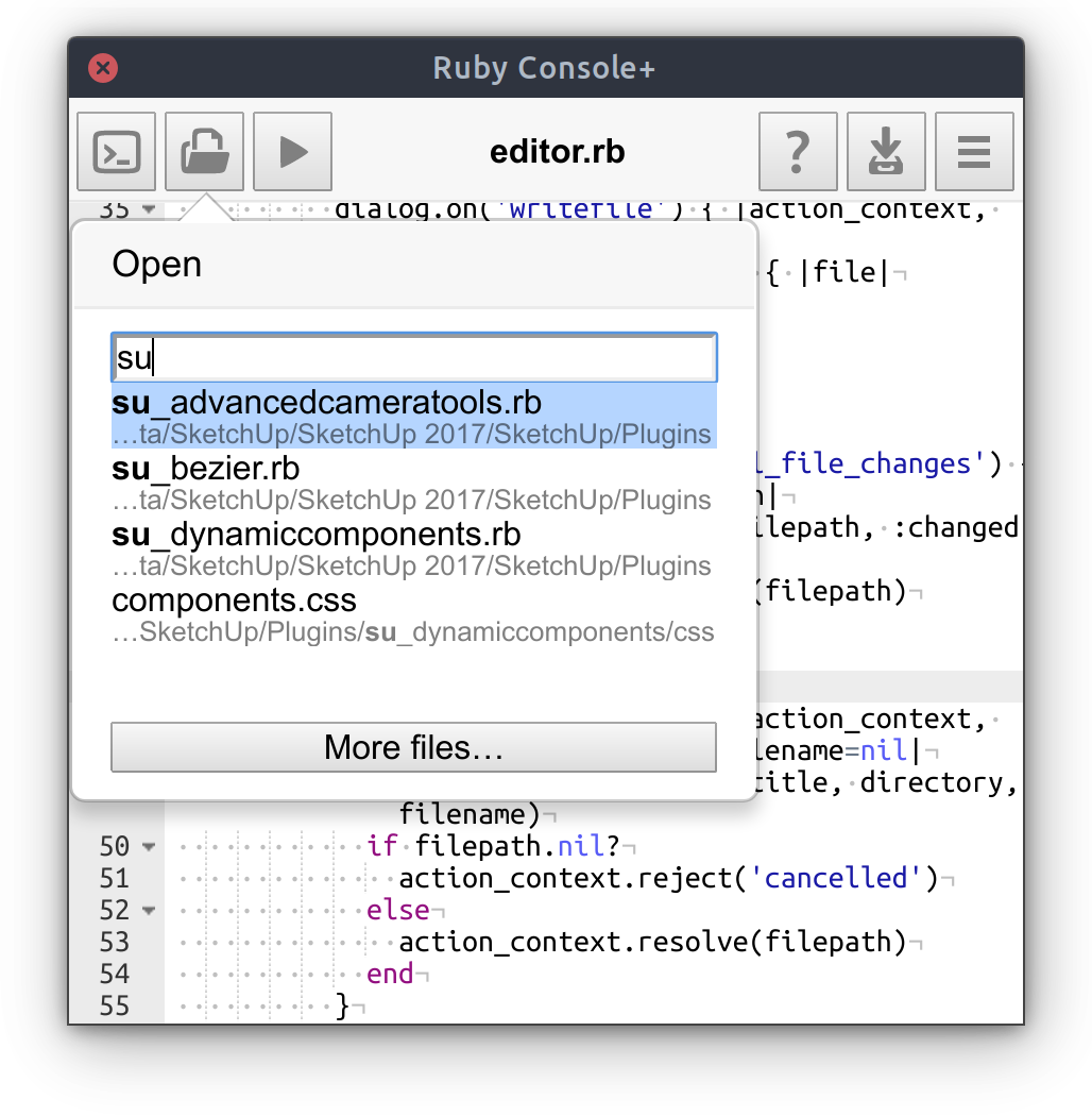

The editor is a full-featured text editor. Here you turn code into a script and save it as a file.

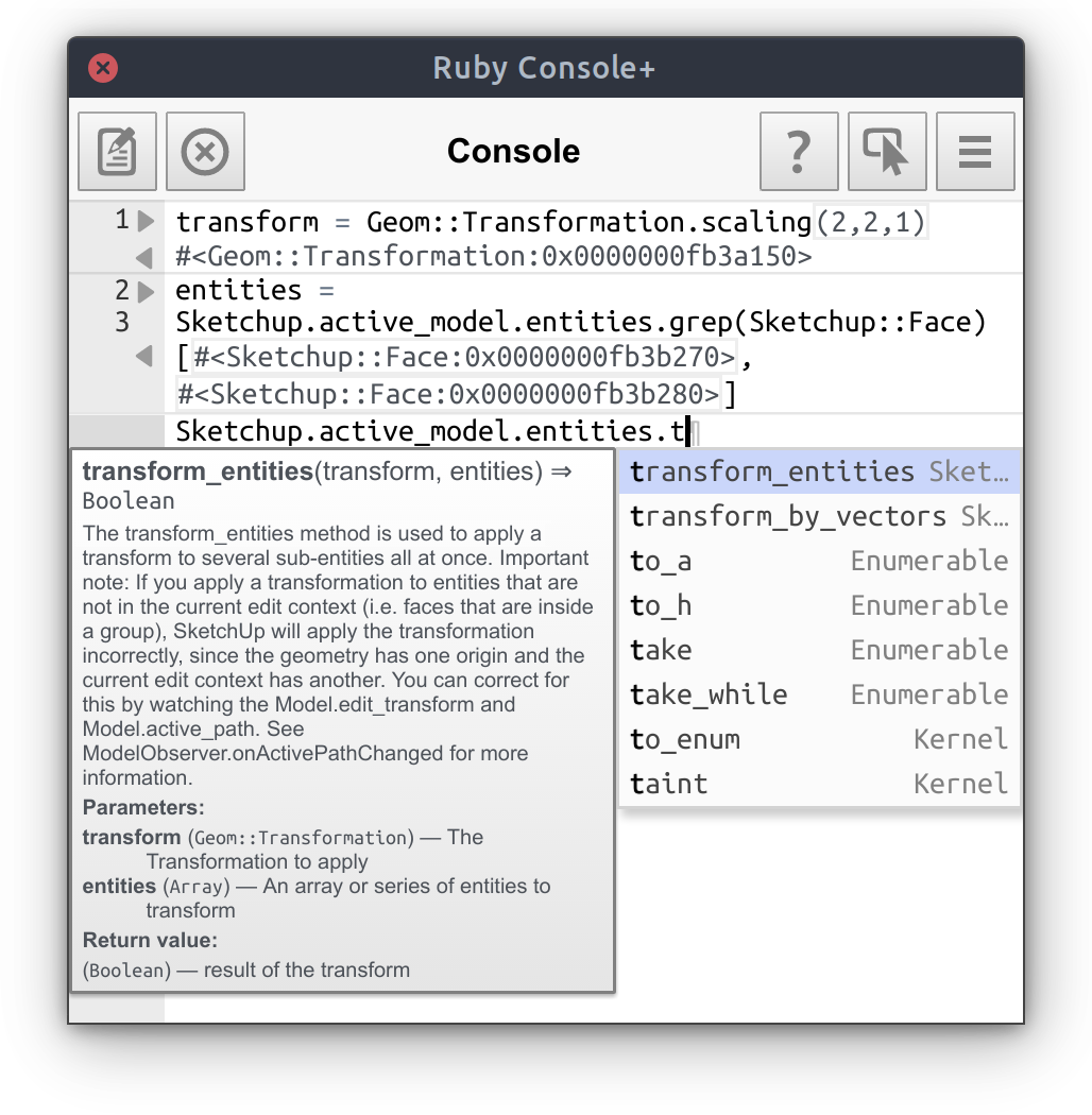

Autocompletion and doc tooltips: Intelligent live autocompletion tells you not only which methods you can call next on a reference but provides you also with detailed info on how to correctly use them. Use Tab ↹ to accept a suggestion.
