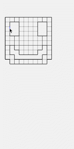

Description: Adds faces that are 'missing' from selected edges.
Menu Item: Extensions > Add Faces [to Selected Edges]
Note: It's not foolproof. Be aware that it might make internal faces you don't expect.
You can call it from other scripts by making a selection-set then TIG.addfaces()
To run manually make a selection and type TIG.addfaces in the Ruby Console
It has a Extensions menu entry, and a Context-Menu item if an edge is selected Add Faces [to Selected Edges]
