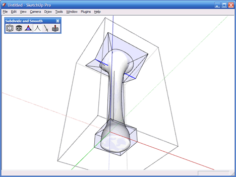

influence of Edges and even Vertexes (the latter normally not controllable through the convential SketchUp interface).

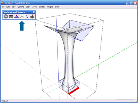

The next image shows what happens when the four Edges are creased.
Step 5
As you can see from the image below, a nice smooth and once again organic transition has been made from the base shape to its footing.
