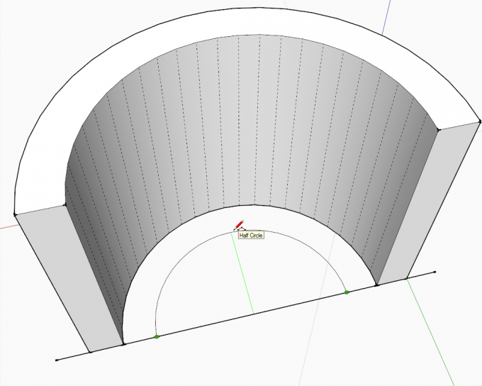

We start with the same, semi-cylindrical wall as in the previous tutorial.Draw arches (and closing edges) on both the inner side...
arched-window-curved-wall01
...and the outer side. Draw them at any distance but bear in mind that if you draw them too close to the original wall, when setting up the arcs inside (below), you may get m,erged into the original cylindrical wall and your boolean operation will not be successful at the end.
arched-window-curved-wall02

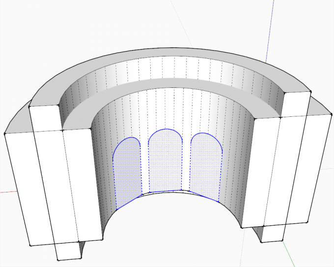

Now do the same thing inside the thicker wall (I have moved the original wall onto a hidden layer and simply deleted the top face of this one in order to access the inside).
arched-window-curved-wall08
When done, all six faces can easily be selected by holding down the Shift key and double clicking on every face.
arched-window-curved-wall09
Now while still holding the Shift key, draw a selection rectangle around the whole model - this will reverse your selection. Delete everything but these faces (which are now deselected).
arched-window-curved-wall11

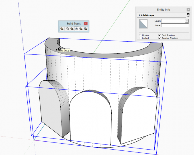

Either stitch the corresponding faces together by hand (drawing edges between their endpoint - tedious way) or use a plugin to quickly do it - I have used Curviloft here (not part of this tutorial). Select all of the created geometry and make a group (it should be a single solid group even if there are three sets of geometry inside - but you can group them separately too and perform the boolean operation thrice). I have also turned on my hidden layer with the round wall of course.
Again (like in the previous tutorial), select the Subtract tool then the window group...
arched-window-curved-wall14
Then select the wall group and click...
arched-window-curved-wall13
And the result (after turning hidden geometry and endpoints off and adjusting smoothness level a bit).
