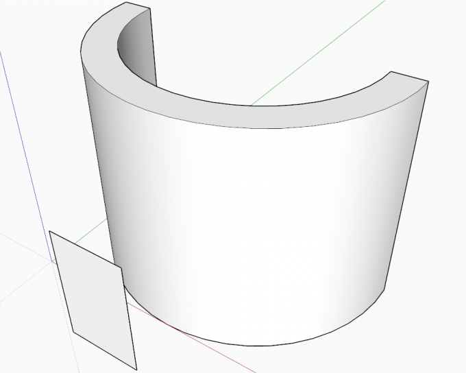

First of all, we draw our wall and draw the outline of the future window carefully positioned before the wall (if needed, use Parallel projection and one of those Standard views in order to be able to do this precisely).
boolean-1
See that I placed the rectangle well in front of the wall to make it safe and get all the intersection nice later. Make sure to make a group of each object already at this stage (you could make components, too - they will be made unique once the boolean operation is done).

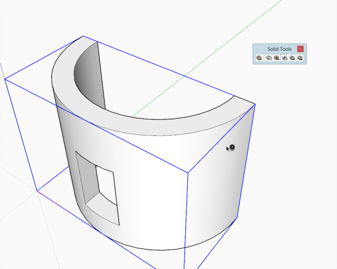

Next select the round wall group (in the screen shot, I am still hovering over that group only - notice how SketchUp "reports" that it is a Solid group - with non-solids, these tools won't work at all and you may need to use the traditional "Intersect" method described below)
boolean-5
Click once and the window group is subtracted from your curved wall group leaving an opening whose inner sides are also created ("borrowed" from the window group) and even the face orientation is changed so you end up with a nice, clean model which is still a "solid".
