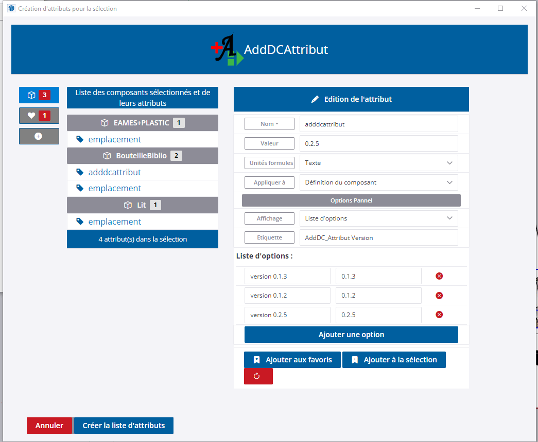

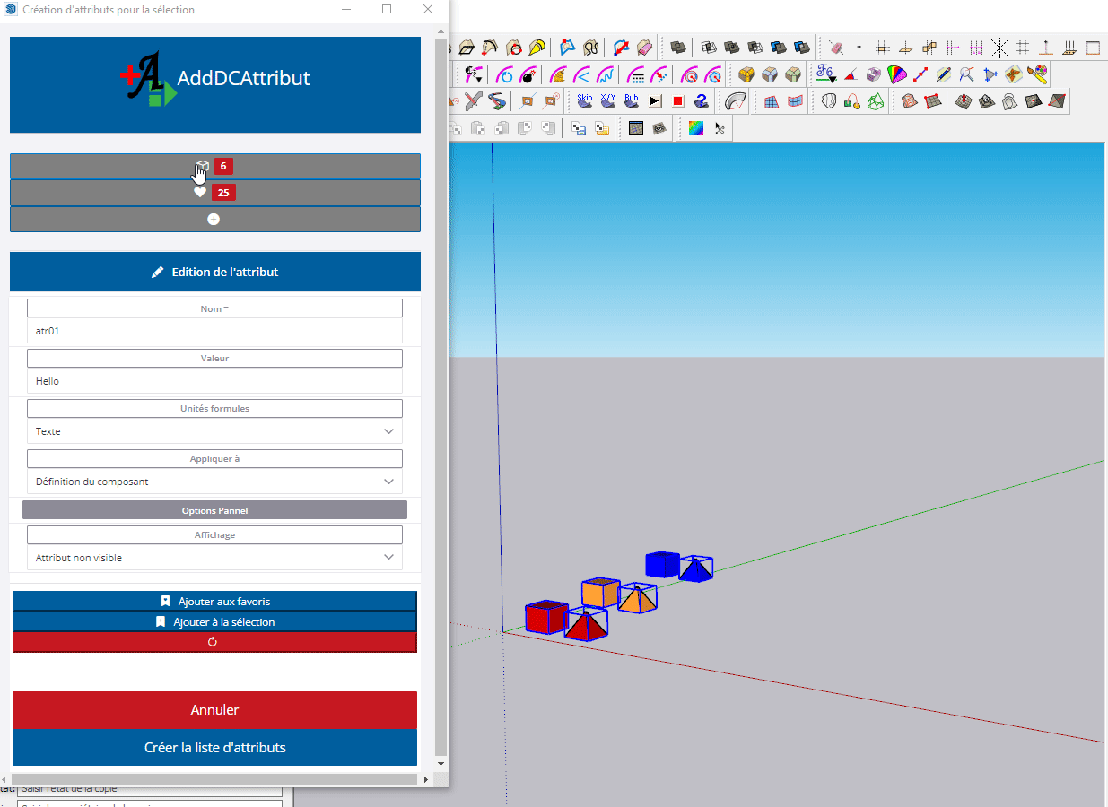

very useful addon. but it does not work for me. or maybe i an missing something. i set an atribute NAME and the value. and after aplying there is still nothing in the component atributes.
andreimd87
- Posts: 2
- Joined: Sun Mar 22, 2015 9:37 pm
- Name: Andrei
- Operating system: Windows
- License type: Pro
- SketchUp use: woodworking
- Level of SketchUp: Advanced
by simjoubert » Sun Mar 26, 2023 11:54 pm
andreimd87 wrote:very useful addon. but it does not work for me. or maybe i an missing something. i set an atribute NAME and the value. and after aplying there is still nothing in the component attributes.
Good evening To create a new attribute or edit an existing attribute: Select an existing attribute in one of the lists (Attribute of a component of the selection, or an attribute placed in favorites, or an attribute of the list to create, modify) or create it from scratch. Once the values have been entered, it must be added to the list of attributes to create/modify. The attribute appears in the list, in case of duplicate an error message appears asking you for confirmation before overwriting the existing one. At this point, nothing is changed in the components of the selection. It is only after clicking on the button create the attributes of the list that the components will receive the new attribute or its new values in case of modification. You can thus create several attributes at once.
